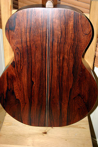

A few Pics of one that will leave tomorrow
It's a Mad Rose SJ.
Euro Top
24.9" Scale

Nice wood combination!

From one Russell to another, great job! I really like this one!

Russell,
Very, very nice

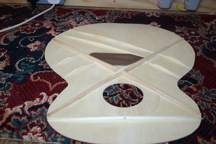

Oh I forgot to save this Picture I've been saving of the top bracing.

Always a nice feeling, sending one on it's way!
PostPosted: Wed Jun 21, 2006 6:56 am

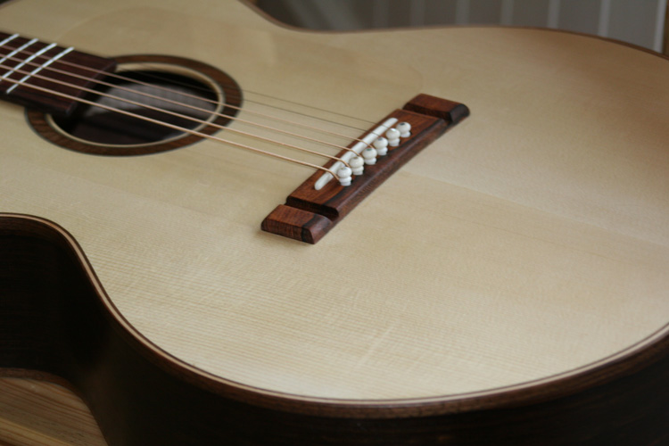

A real beauty Russell, That Euro top is outstanding! Cool bridge too! What do you use for your finish ?

Hesh
It is indeed, I've used a Parabolic Arrangement on 4, 2 I have completed and 2 I'm just finishing up. This one is very responsive, I built it pretty light and even before the strings were on it vibrated along to the music in my workshop. What I've found so far with parabolic vs scalloped (at least the way I've executed them) is I gain speed of response with the Parabolic, but lose a bit of headroom. I'm getting the same nice balanced tone with both.

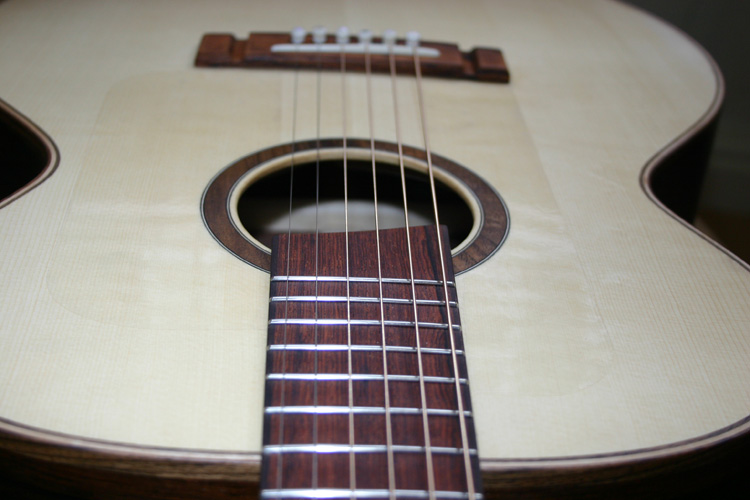

   Gorgeous guitar Russel! I really like that Mad Rose... And that rosette is very nice as well. How is she bound? Is that walnut (rosette and binding)? I'm also very fond of the way the finger board protrudes over the soundhole... I just might have to stea... I mean, borrow that one from you...

The binding and Rosette are Walnut.
